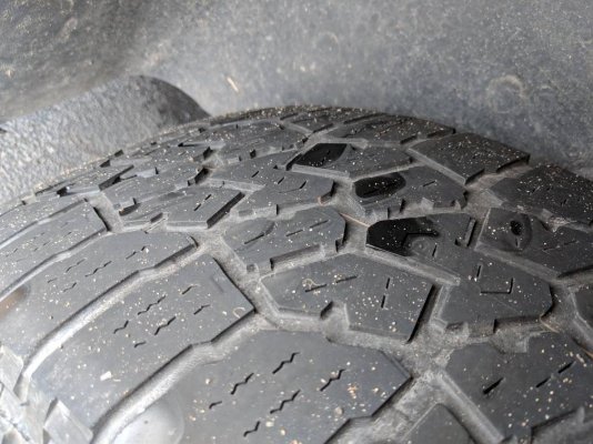

I put these on last year. I do outside sales in oil and gas. No issues with off road/lease/gravel roads. I've had a razor blade in one tire that didn't puncture the tire and I've got a screw in one now but it's still holding air.
I'm over 60k on this set of tires and I just bought a 2nd set. And I did a horrible job of rotating...probably only rotated 3 times.
New tires
Front tire
Rear tire6bc4013fb22e56c4b4f7073d05639468.jpg4632e8d1e45f7df11b912403eaa7b7e5.jpga1b6d6c8e76081e5dbe3eb1716390ebe.jpg

Were those LT tires or reg?
