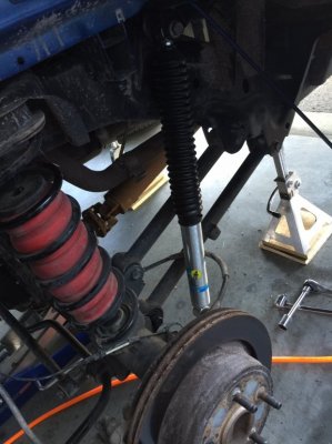

I've been leveled with HBS 2.5 spacer now since about Sept. Haven't been too happy with it, and we are now 20 days from hitting the road full time. Getting new tires on the 16th and gathering all the parts. This afternoons project, swapping out the old lift for Bilstein's.

Nice! Got my Bils installed a couple of weeks ago, ride is much improved IMO. Say, is that a BOB I see in the back of the truck with the front wheel removed?

Does anyone have any tricks to the top bolt on these rear shocks or are you all just taking them to a shop. Because this is just absurd. I've never had such a difficult time in my entire adult life removing one ******** nut and bolt.

I cut OEM plastic shroud off upper strut to gain access to the shaft and used vice grips. The rubber isolator leaves little room around the nut to get the wrench, and even then, you'll just round the 10MM hex that's supposed to hold the shaft for removal.
I did mine with 7K on the odometer and everything was shiny new and we still rounded the nut on the first spin.

Yeah, I took the inner fender liner off, wow. That made me feel like I'd never done shocks before. Oh, and I get to contend with the fuel tank on the other side. Sigh... :roflsquared:
Gonna be getting beers tonight, that's for sure.

Disregard quoted post, I failed at reading comprehension. That's what I get for goofing off at work. This was in reference to front end.
Glad you made headway.

I cut the box end off a 13/16 craftsman wrench and stuck it up there. Bout three inches in total length.
