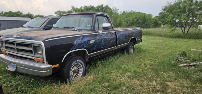

Also its a southern kept truck. Will check it over prior to moving it and snag pics should be surface rust.

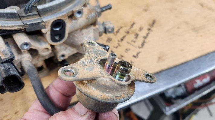

Sounds like you've been around this block. What experience have you had with the TBI? Is it the injectors? Or sticking throttle plates? Or ???

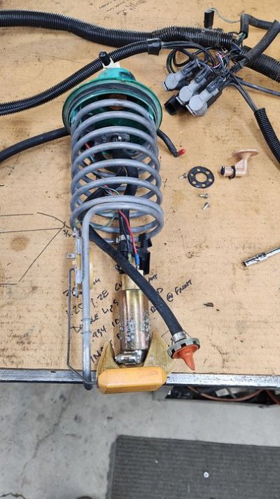

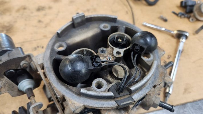

I have a few pics of the TBI from when I rebuilt the one in my forest service truck thread. I'll post a couple here. And a pic of the in tank fuel module so you can see how generic it really is.
