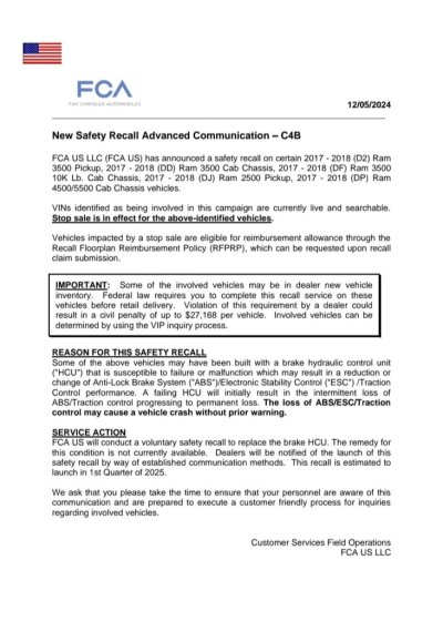

Got this today on my 2018 Ram 2500 , Finally a Recall on ABS issues .
NHTSA Campaign Number: 24V896000
Manufacturer Chrysler (FCA US, LLC)
Components SERVICE BRAKES, HYDRAULIC
Potential Number of Units Affected 317,630

This is what it says on my recall Look on the NHTSA website .
Summary
Chrysler (FCA US, LLC) is recalling certain 2017-2018 Ram 2500 Pickup, Ram 3500 Pickup, 3500 Cab Chassis, 4500 and 5500 Cab Chassis vehicles. The hydraulic control unit (HCU) may fail, which can cause the anti-lock brake (ABS), electronic stability control (ESC), and traction control systems to fail.
Remedy
Dealers will replace the brake HCU, free of charge. Owner notification letters are expected to be mailed January 9, 2025. Owners may contact FCA customer service at 1-800-853-1403. FCA's number for this recall is C4B.
Summary
Remedy
"certain" lol
Thanks much for sharing, though. Seems some owners are getting prior to others, I would expect to be included. Which now makes me wonder if they're going to want to do a PCM re-flash - I got a tuner PCM. Sheesh - if they wouldn't have dragged their feet (thanks, FCA) on this for so many years, we wouldn't have these GD legacy issues. Sergio wasn't much better than Tavares.

Problem is with no parts available it'll all just sit in a lot and rot until they make 3 or 4 of them ha! Love the new world customer service these companies have.
