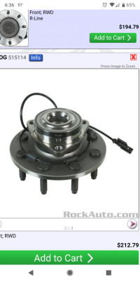

Look coming off the back of the hub behind the shield for the rotor....if you have abs you have wheel speed sensors. That's why you need the code read so you know exactly which one it is. Mine was the one on the pumpkin when I had it but it can be any of them.
You can see it in the picView attachment 165366
Oh no. When i replaced the wheel bearings this February it didnt have any wire from either of the bearings.

Maybe a different set up....coming from gm maybe some dodges still use a reluctor wheel and sensor? What year truck? That pic was for an 06 3500 ram which is the same style gm uses. I do know if you have abs you have a speed sensor somewhere

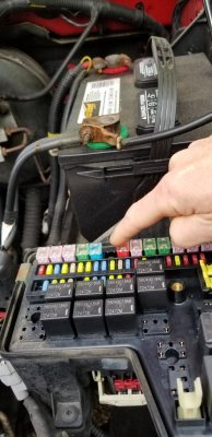

My 04 2500 has the speed sensors which can be quite finicky with shim configuration and sensitive to rust.
I ended up pulling the 40a ABS pump fuse to eliminate pulsating brakes. 15573192235512622069944828350757.jpg

What about the brake light and ABS light now being displayed ?
I can't see it.....ingenious ingenuity. Lol15573202398944674582930729872345.jpg

I ended up pulling the 40a ABS pump fuse to eliminate pulsating brakes. View attachment 165420
Tried this on mine and now the both brake and abs lights stay on
Sent from my SM-G973U using Tapatalk
Yeah it's a trade off.....both lights will stay on but in my case I simply got tired of playing/adjusting with the speed sensors.
The ABS would prematurely activate.
I'm old and know how to drive and don't need ABS. Lol
My truck brakes much better now and peice of gorilla tape over lights.....all is good.
