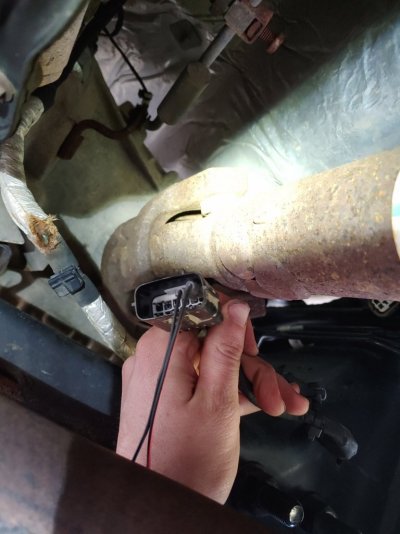

This might be kind of a long shot, considering you said they did continuity testing and overlaid new wiring the speed sensor from abs module, but I had very similar issue and may be worth a shot.
I had same code regarding rear wheel speed sensor intermittent would come in when it was very wet out or snowing, etc. However, it also would come in when hitting bumpy roads or a pot hole. I found a break in the wire bundle that the driver side rear wheel speed sensor was ran through when it was routed over the transfer case housing/shroud. It is a sharp sheet metal guard and you have to lift the wire bundle off the guard to see where it was rubbing through.
