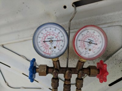

I am having the same problem with my air conditioning in my 2001 Dodge ram 2500. I just replace the AC line that has the fixed orifice tube and I noticed the line was full of gunk. I vacuumed out and recharge the system and the air conditioning work great for about 5 minutes then started blowing hot air. Here is what the gauges read when the AC system was on maximum and blowing hot air.
