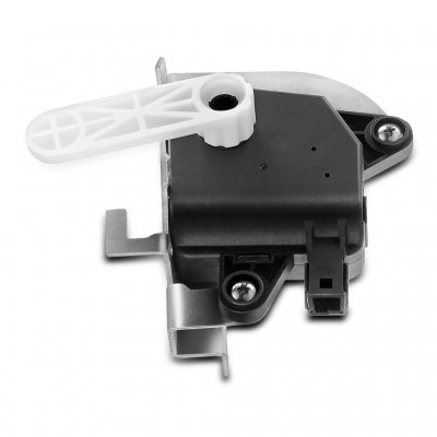

Take your Ram to an independent Auto Air Conditioning & Radiator Shop & get it diagnosed
They usually have a Scan tool that will check out the 4 motors
The motors are called Actuators
