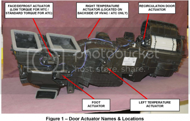

You didn't say what they have or haven't found really. Freon in the system, yes, no? Compressor turns on?
If it has freon and the compressor turns on I wonder if they checked the left temperature actuator
If it is bad it will only blow warm air.
Edit: missed your update post somehow, but keep this in mind.
Thanks, though. The truck was only blowing warm air, which is why I figured it was low on freon. AC indicator in cabin said AC was engaged but apparently the compressor wasn't even turning on. Seems like they should have checked that first before checking for leaks! Not covered by warranty, of course, which is fine. Just hope it doesn't recur.
