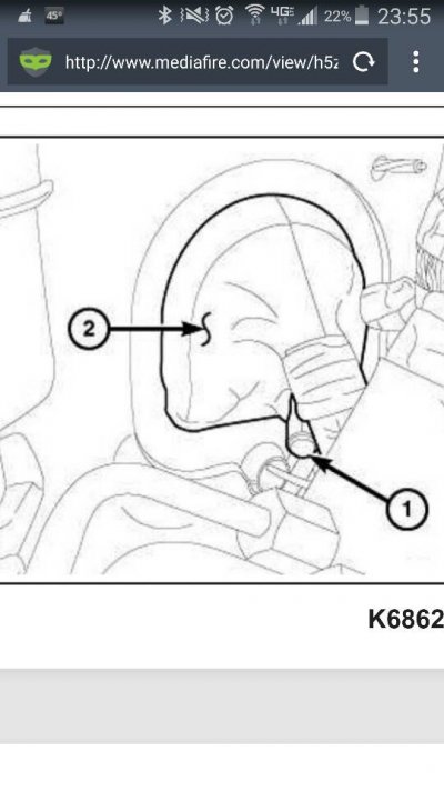

Ya there is a 3-4 inch long black piece on the firewall opposite the steering wheel. It's held on by two 13 mm nuts from the inside of the cab. It's a pain with a ratchet. If you got an air ratchet it's a breeze. Pop out out and drill it. Or just leave the thing there and drill it. You should be safe if you use a short bit.
That plastic plate just to the right of the boot mentioned above is where I ran the long body harness for the OEM backup camera. I just drilled a hole it it while leaving it in place , installed a rubber grommet and ran the harness through it . This worked out great and I now have room to run additional wires for future mods similar to the OP.

This is an excerpt from the OEM backup cam install instructions , the body grommet it mentions has a large wire bundle coming through it , the nipple (1) can be cut off to rout additional wires for mods.
Hope this helps !
