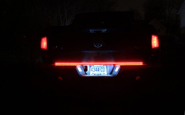

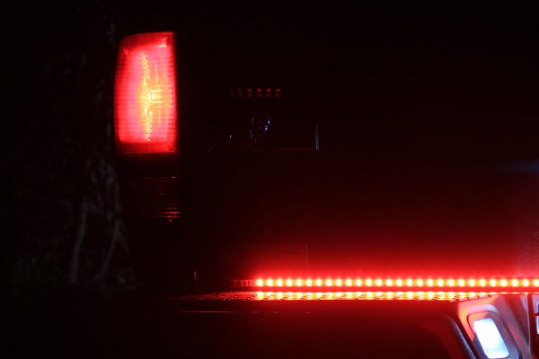

Got another small mod. I added the Recon Line of fire bar to the back of the Truck. Had to add more light to compensate for the tinted tails. I took some precautions on it. I used some auto/marine sealant to seal up the bar to prevent moisture. I did the top and bottom and sides. Looks like the lens over the LEDs are just snapped on so the seams are loose. Also on the side where the wire comes out is a loose fit there. Potential leak spots. It comes with the 4 pin connector but I didn't hook it top the combo 4/7 pin plug I have next to my plate. I bought another 4 pin connector and tapped off the wires on the plug that is on the back of the combo plug. So its still removable if needed and didn't modify the Recon bar at all. It came out good and way brighter than my tails.
Here are some pics of it.
Just the parking lights
Brake lights on
Here is a close up
