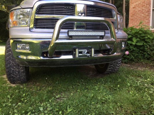

I have a 12k winch behind the bumper of my 2012 1500.

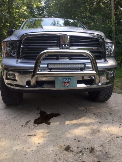

Front plates are not required where I am, but I made some clips out of PVC to attach a plate to hide the rollers and hook.
