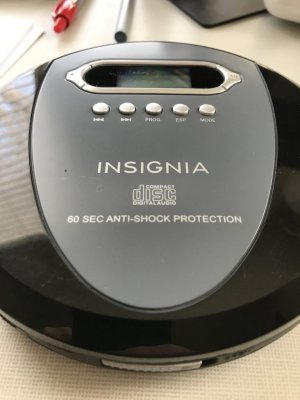

I just found this CD walkman in my basement. It’s works great in the truck using a 1/8” jack into the Aux. while the sound quality is there, the only downside is not having control of it while driving (or track info on the screen). If I want that, I’ll have to step up to the OEM or Amazon version for a few hundred bucks.
