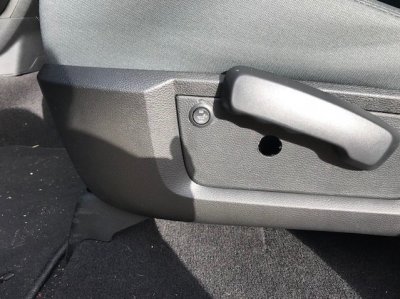

One note: if you mount the switch on the side of the seat, make sure you don't put to where the handle goes like I did!
I ordered a new panel to redo it so I don't have a hole

Just make sure you don't put the switch where the adjust handle is....I am such a donkey!

I was able to fit the switch on the side of my seat and not have it interfere with the handle (well it took me a couple of tries to get it right...doh!)

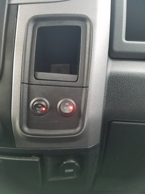

I just installed a kit from Amazon Warehouse last weekend. I picked it up for $26 when regular price was close to $50 and they work great!! I installed the same set in a car a few years back and never had any problems with them. Here's where I installed the switches. I figure that piece would be super easy to replace if I ever went away from them for some reason.

I did exact same spot with the square switches. Fits perfect and looks kind of factory. Just had to add some wire to the switches to reach that spot. This was a GREAT upgrade for both fron seats for 40 bucks. Gonna do back seats too when I do Katzkin upgrade next month.
