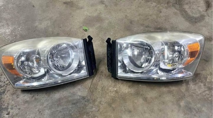

FYI, these are the style of headlights I have.

Could I just order something like this? They seem to be projectors and come with LEDs- no idea how good of quality they are, but they do come with them...
mrack
Feb 14, 2023
710
1,003
Michigan
Sorry, didn’t realize this was in the 3rd gen section. Everything I said was assuming you had a 4th gen. Can’t help you there

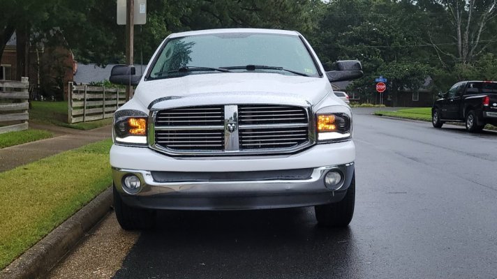

My setup. Morimoto Hybrid LED from "Headlight Revolution". Very bright nice focus. Not inexpensive but they are on sale right now.
