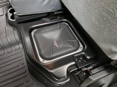

So I’m looking at upgrading to kicker speakers in the door and a sub under the rear seats. I was wondering what Others did that did something similar to this.

The Kicker Hideaway works nice, it's not earth shattering bass but fills in the low end a lot better than the door speakers. It fits behind the back seat so it doesn't take up the storage space under the seat. Kicker now has a 10" version out also.
You can also jump up to the SRAMCQ09, more power but you lose the storage space under the back seat on the driver's side.
There are a few other aftermarket subs that I'm sure people will chime in on.
