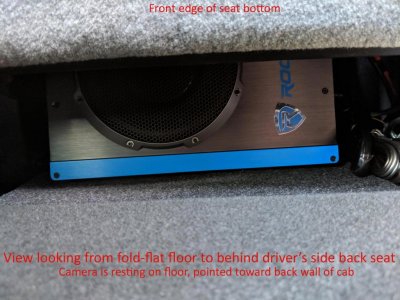

If you want to retain the fold flat floor, an under the seat powered sub is the way to go. I went with this one:
https://www.amazon.com/Rockville-RW10CA-Profile-Powered-Subwoofer/dp/B019Z3RFGY?th=1
Because of fitment issues I got the one with the 8" speaker. I put mine behind the back seat.
It does not bow the windows outward when you play music but it provides a nice thump, thump, jiggles the seats and mirrors, and fills in the lower end of the musical scale quite nicely. I hear bass notes in songs that I've never heard before.

What did you do for power to this one? And do you have a crew cab? I didn’t think there was room behind that seat. I’ve upgraded my head unit and front speakers, but need a little more low end, so this sounds appealing.
I have a crew cab. I did the back seat modification which allows you to tilt the back rest of the back seat forward and gain access to the space behind it.
https://www.ramforum.com/posts/1769526/
I had Best Buy Geek Squad install it for me, cost $99. They ran a thick power cable to the battery with an inline protective fuse. The subwoofer signal taps into the left and right rear speaker wires. They used a line output converter (LOC). I think the cost of the LOC was $9.95 or something similar.

do you have a picture of the install? I’m curious as to how/where they mounted it to the back wall. I’ve got an aftermarket head unit already with a sub out, so I wouldn’t need the LOC. I’ll just have to run power and the signal from the head unit.
It was installed behind the backrest on the driver's side of the back seat. I have a couple of pictures, they are closeup shots.
