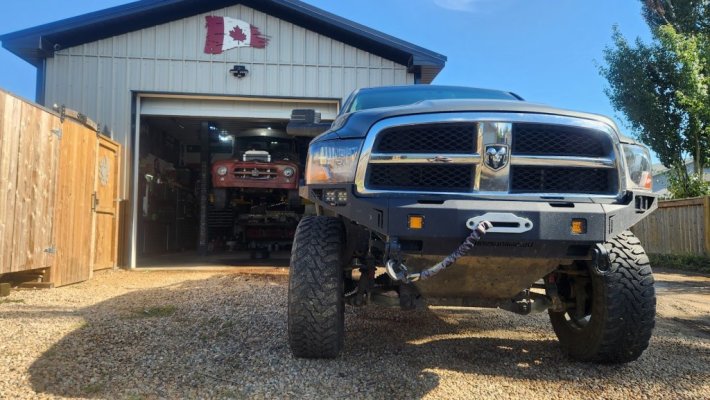

If you plan on a bumper and winch you need 6112s up front. The 5100 are way to soft for that weight. I made my own front front bash plate. ( Way cheaper and actual 1/4 plate ) As I kept getting hung up. And 1500s dont have stabilizers ;)
The bumper you posted seems way to big for nothing. Specially if you're actually off-roading and not a pavement princess like 99% of the guys here. Check out ChassiUnlimited. Solid AF and the slimmest one available with a winch.
My gas tank has gouges in it... lol... But still holding up miraculously. And I have a PPE pan so that also helps. compare to the plastic factory junk. But Ive never hit under there. :driver:
Word of advice, you'll snap lots of CVs with a 6" lift when pushing it hard whit heavy ass 37's . Thats why I had to add limiting straps. No Sway bars up front either :cool: . For the rear get resis . i used 5165 but lots of good options.
Also all the extra weight of overlanding and full size spare I added airlift 5000 with crattles. if not youll rip your bags. As you can see no sway bar in the rear either ;) Flexes way better off-road
You'll also want jeep gladiator or similar springs I Use EVO 6.5" ones. Clayton or Core Track back and 4 link. The factory bushing are soft as jello.
Don't forget the TrueTrack and 4.10 / 4.56 with those 37s
There's a few other cool builds on here as well that the guys actually off-road. Hopefully they chime in.
And After all this work I now Off- road with a Jeep JK :dogpile: :favorites37: Because I cant fit in the cool trail in BC with this pig... lol...
