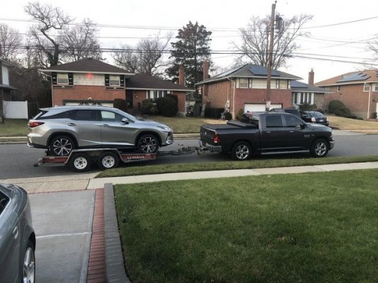

5.7 4wd with 3.92. I have since added bags, as you can see, I am nose up. But I towed this from Long Island NY to Palm Beach FL.

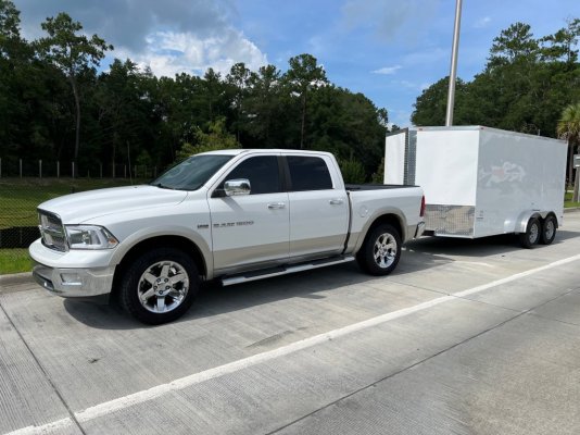

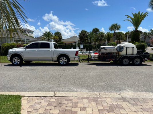

I have the same 1500 5.7 3.92 you may want to get rear springs first from tough truck 1211 coils, I Just ordered mine. then again, I am probably be heavier than your tow set up. second pic with less water. 350 vs 175 gallons.

Weight
1500# machines
950# trailer
water
3173 vs 1461 350gal vs 175gal @8.34lbs a gallon
650-850# misc. equipment
6223 vs 4050
What bags are you using?
Weight
1500# machines
950# trailer
water
6223 vs 4050

I just put the 1211 rear springs last night. Its super easy.. best $190.00 I spent for towing
