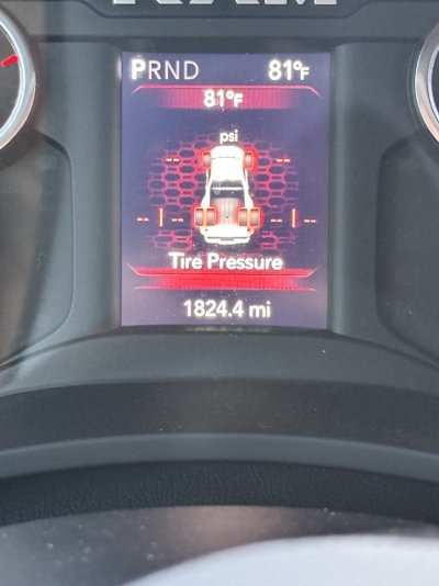

PSA for current and future owners of the Procal Snap for 19+. When programming tire size holding down the brake and cruise button for longer than 3 seconds can put the system into fault mode. This happened to my rig and a friend's rig. On his he wasn't sure the issue, (as in if it was the AEV or an issue from the factory) took it to the dealer and they said his ABS module was bricked. He has been without his truck for 4 weeks and missed several events as he waits for the part as it's on a national backorder.
Well, after many hours of googling my friend ran across this bulletin buried deep within AEV. It took several attempts to solve but following those steps seemed to fix the issue on both trucks.
Dash picture from both trucks. Mine on top his below.

I seem to be having this issue now with my 2024. I was able to get everything connected and programmed correctly. However, using the gps on my phone and then comparing this to my speedometer, I was off anywhere from 4-5mph. I know the GPS on my phone is accurate because I tested it not only on my truck prior to swapping the wheels & tires, but also tested this on my other vehicles.
So I found this thread and of course redid everything as posted for the fix and still have the check engine light with the code in the picture. Also, the TPMS SENSORS are now empty.
I guess I’ll just drive it for a while and see if everything clears out. My Scan Gauge 3 won’t delete the code either.
Also, have you guys checked your actual speed using a gps compared to what your speedometer is showing? Are you accurate?
