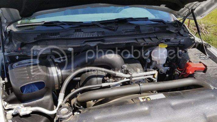

Not sure if the gain would have been much had I installed the CAI before upgrading the exhaust & Pulsar but it was very noticeable doing so afterwards. Super pleased w/ the quality, appearance & performance! Thanks to Nick @ GotExhaust for the discount & same day shipping! Some may wonder why I didn't go the VaraRam route - I wanted to keep an airbox in place to obstruct the Pulsar from view for when I take the truck in to the dealership for oil changes. Not overly keen on having to remove the Pulsar, unless absolutely necessary. That was also the reason I passed on the S&B option... if/when I do need to remove the Pulsar for a service visit, I didn't want to deal w/ a PITA CAI removal process to get access to the PCM. Long story short, the Momentum GT Pro 5R was the best option for my needs & I could not be happier w/ the results. Pulls harder throughout the entire RPM range, SOTP gauge so take that for what it's worth but I am confident this was a worthy upgrade.

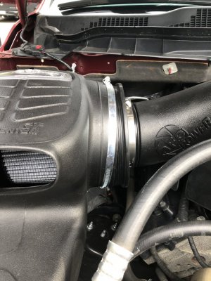

I have the same one and I am having issues with the filter falling out of the box. No matter how much I tighten the clamp down it keeps slipping out of the air box. Are you having this issue too? Anyone else with this intake have this issue?

Just checked, the filter hasn't budged on mine.

I suspect you tightened the clamp too much initially which forced the filter to back out. You can see the housing is squeezed in due to the clamp being too tight. Attempting to tighten it further would only serve to worsen the problem. I tightend the clamp only to the point that it was firmly in place & couldn't shift on the housing. Pretty confident that's your issue.
