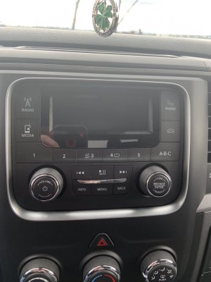

Want to put in after market radio in my 2018 1500. What will I have to give up?
What radio do you currently have

You should be able to replace the radio with the basic adapter harness and be fine. If you want to have access to everything that the higher end factory radio's can control (most features are controlled thru your evic already) you can add the idatalink maestro rr and ch3 and have access in your aftermarket radio as long as it's idatalink capable.
