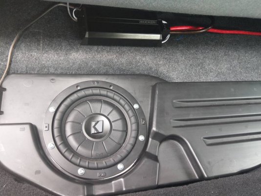

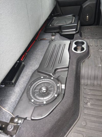

You didn't have to buy anything else? Just installed the JL subwoofer, kicker amp, bought the appropriate wiring and you were good? And all in the factory plastic box?
Yes, I know you can only get so much with the factory cheap plastic box. But since I've yet to find a box you can buy that let's you keep the fold flat foot, this sounds nice.
