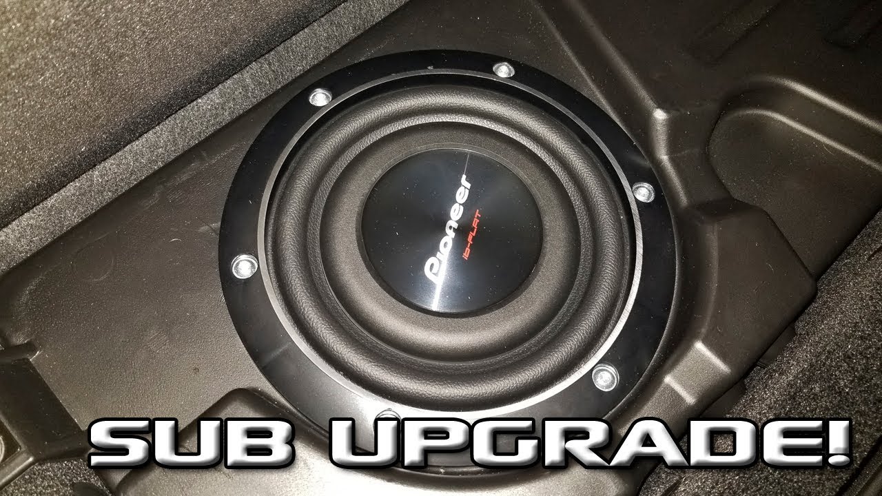

Hi, there has been quite a few other threads on different forms and some YT videos about it. I’m looking to do it also, favoring the pioneer sub. Seems like a pretty simple task, here is a YT link to one of the videos. I would post the other forum links, but it might be against the rules, a google search should pull them up, just look for “replacing OEM alpine sub ram 1500”
Edit: keep in mind it has to be a shallow mount sub if you plan to keep the original box, there’s a few people online that have put the dimensions and what you can fit in the oem box. You’ll need some metra harness adapters also. I believe it’s a dual 2 ohm voice coil, but the video should say. It’s recommended you seal the factory box and stuff it with poly fill, some people also line the box with sound deaden mats, to try and give it more of a punch. Hope this helps

I see people put an 8” pioneer sub in place, the shallow one, and some polly fill, not sure how much it really does.
I just installed the pac ch-41 sub harness so i was able to install an alpine 600x1 amp and 12” type s sub in a box i made to fit where the factory one goes. Night and day sound, it punches hard and changed the whole sound of the system. I also replaced the dash and rear door speakers with infinity’s

Just do the shallow pioneer listed above, have been running mine for 9 years.
It's a noticeable difference as far as how clean with a little added volume and you keep the fold flat floor.
*Edit - If this is close enough just go grab this, had one in my 08' PowerWagon, sounded good! -- https://www.facebook.com/marketplace/item/1598412848131866/

@RyanDavidPonter --> here is what I did -- and it's been _fantastic_ (IMO!)
