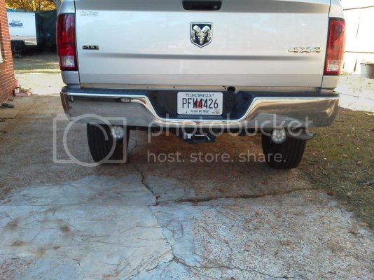

Finally finished this project. I purchased two cheap 18 watt LED flood/fog lights off EBay. I made an L shaped bracket from some flat stock and mounted the lights onto the rear of the frame horns using existing holes. The lights are wired into the backup light wire on my 7 pin trailer harness so they come on when I place the truck into reverse gear.

My install is similar to Wandell's, but I added a small rocker switch to the lower left panel dash panel so I can activate my lights when hooking up to my travel trailer. They also come on when I put it in reverse. The lights were about $36 on ebay, no brand name,the box they came in had no print on them at all. Also used a 30 amp relay, which I mounted under the dash instead of mounting it underneath the truck. Used wiring loom on all the wires on the exterior.
The lights had not been adjusted correctly when I took the night shot.

I havn't adjusted mine either but here's a night time shot. Pics don't do them justice, they are bright!

One more pic of the lights installed.
