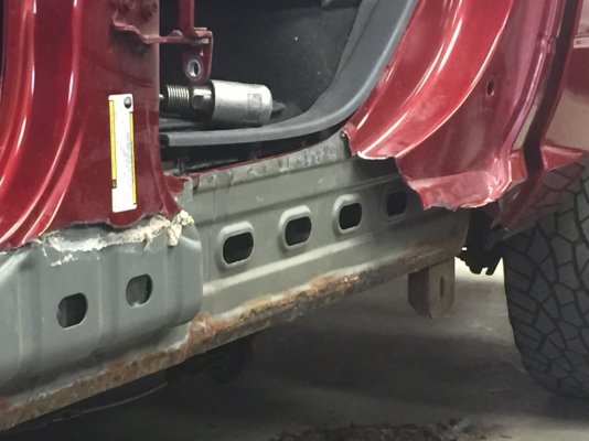

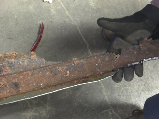

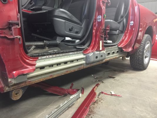

Well I ended up going to the dealer and got both unisides for 218 each and the cutting and replacement as started. Btw I needed to do the entire rocker and both cab corners right and left
75c5a7e43783483486df39190a84e597.jpgada583b2b70254bb8e090b7083de6701.jpgf3eeae62f67defe5b8dd03bba20ae18f.jpg

Yeah it's terrible. 09 and it's so far gone like this.

And that I had to do the entire rocker and cab corners. It will not happen again. Plugging the holes for drainage and having it line ex ed or if your familiar with raptor is the material I'm using.. It's bedliner material that can be tinted and color matched to body color to help hide it

Wow that sucks. Cant believe thats a 6 year old truck.... And it looks like primer only inside the rockers? Was there any foam anywhere inside there?

No foam. Only foam is in the middle b pillar. It will be sealed off and since I don't off road my truck and don't go driving through streams I can get away with sealing off the rockers

So do you live somewhere that they use lots of salt on the road, not wash it much ? Not being a butt with that comment just wondering how that new of a truck has that much rust ?

I live in Pittsburgh. Yes we use a lot of salt and a liquid that is even more harsh then the salt alone. I try and wash my truck once a week in the winter. But I have Westin steps that apparently like to collect snow and ice. I wasn't to quick to clean that off the steps in the corners the first year. But the damage had already been done. By the time I realized it. Yeah common sence should have clicked and I should have known better but oh well after this is done I'll have 1600 bux wrapped up in the body work.
