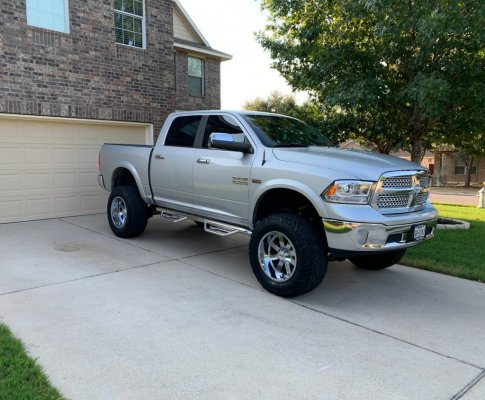

Got into a fender bender last week and needing a new front bumper. Looking to go aftermarket, most likely RCX. Only issue is that I have a 3" BL on top of my 6" suspension lift. I installed the BL 7 years ago, so I don't really remember the details of the attachment. Anyone else gone aftermarket bumper with a BL? Just wondering what I'm getting myself into. TIA guys.

I just welded a new 1/4 plate on the bumper mounts and made some gussets.
B.L include brackets with the kits, but they are usually thin garbage that wont hold up verry well to aftermarket bumpers and winches.
