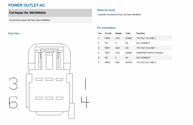

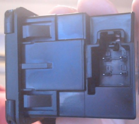

I purchased the power outlet and bevel for the 115V power outlet. I do not want to install the factory inverter. I would however like to use the nice factory outlet to blend into the dash. The problem is that the back of the outlet (#56046934AA) has a connector for factory wiring. I took apart the outlet and there is no good place to connect a regular wire from aftermarket inverter. Is there a way that I can get a pigtail with that connector?WIN_20230516_16_39_56_Pro (2).jpg

I want to do this also.
Have you completed this project yet? How did you finish it?
I was looking at the outlet and had planned to cut the factory harness off and use it for the aftermarket inverter.
