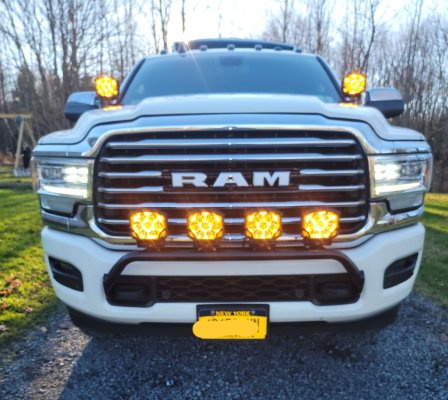

Just throwing it out there, maybe there could be a dedicated thread stickied describing what folks have used, what parts they've had to gather and how they setup their aftermarket/off road lighting for their RAM. I can post some pics later.

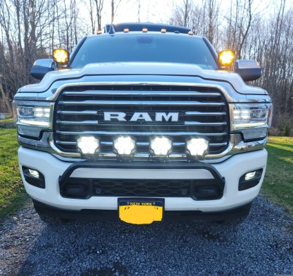

Randy Ellis Design Sleekster light bar mount
Morimoto NCS Bigbanger spot lights x2
Morimoto NCS Bigbanger combo lights x2
Morimoto NCS Bigbanger yellow combo lights x2
Morimoto ditch light brackets x2
Morimoto Bangerbar Power Harness
Diode Dynamics 1m Deutch 4 pin extension harness x4
Diode Dynamics 3m Deutch 4 pin extension harness x2
Nylon bushings from Runnings x4
Micro fuse tap x1
I use the first two upfitter switches to run the spots on #1 switch and the combos/ditch lights on #2 switch. Bangerbar harness tucked up behind the bumper/grill and tucked up out of the way in the engine bay.
