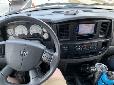

Good luck! Not sure which adapter for the steering wheel controls. If you don’t like the picture frame Metra dash kit, I got this and love it. Needed to do a little cutting, but it comes with a template that clicks into the dash, so no guessing needed. I had the radio without navigation, and this covered up the half circles perfectly. The small pocket is pretty teeny, and not very deep, but I think it looks better than the Metra kit even if I don’t use the pocket.
https://www.amazon.com/gp/aw/d/B01C0J7EMA?psc=1&ref=ppx_pop_mob_b_pd_title
