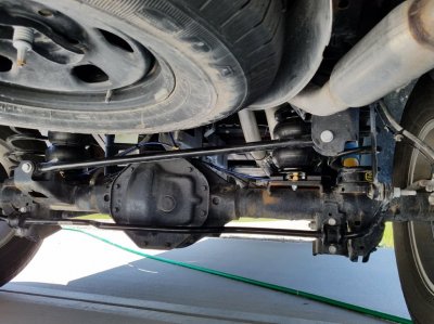

If you wamt a good set of air bags you want Timber Grove air bags.
Quality is top knotch and the fit is great and they are easy to install .
Run 5psi and get no lift or run 15 to 20psi and get 1 to 1 1/2" lift.
Do those bags replace the coils or work along with them? I'm looking for bags that replace the coils. Those look great though!
Edit: From the pictures I see that they work along with the coils
