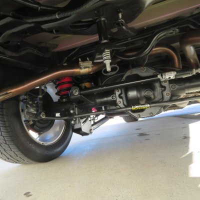

Look into the bags that go inside the springs,you can air them up for when the trucks loaded,then air them back down when not needed.
If you look close i had them in my lowered truck,but they were there strictly for drag racing,but they'd work for you to.
If you go that way,run each bag on it's own air line,i had my fittings in the licence plate bolts.
