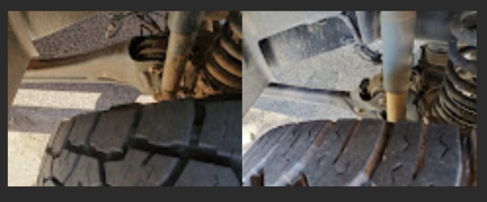

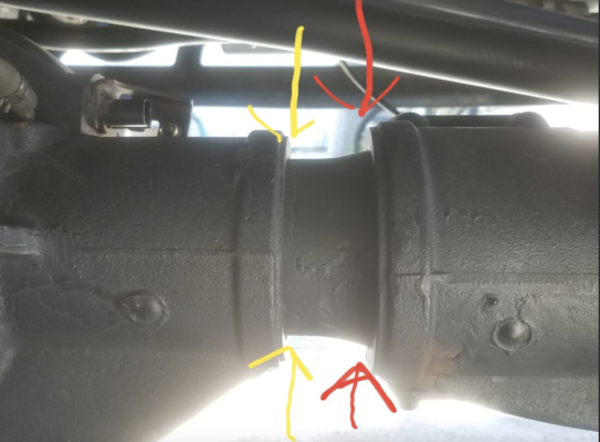

I wasn't saying that the arms are the deciding factor in payload/towing capacity. Just that they are different, unlike the myth around here that everything is exactly the same except the soft springs. The front axles are different too. Why, I dont know. if anyone has that info I'd love to know the reason. Same with the front arms. Are they different to accommodate the articulink, maybe?.?.?. And yes, they tow well. I said it before, Great trucks.
I think the different view points are coming from whether you are just talking about a certain trait of the truck (i.e. payload specific question of this post), or if you are comparing the trucks overall. Sure, there are many differences between a Power Wagon and regular 2500. But this post is talking about payload capabilities, and in that regard the main difference is just in the different springs.
Just for information. The articulink front arms on a PW can be directly replaced with normal arms, or vice versa. If you look at pictures of both they are almost identical with the exception of the articulink arms have a jointed front upper axle connection versus a solid mount on a regular 2500. I would say 75% of the arms literally looks identical to each other with the exception of the joints. For differences in the front axle, it's the same basic axles assembly with the PW having the locker installed in the axle. You can instlal the locker assembly into a non-PW front axle, and again vice versa.
