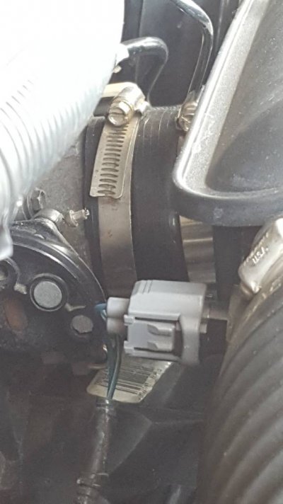

Yes that's the one any idea where I can get a new one?
I bought this at AutoZone. I measured the opening to the TB and box and just bought a connecter from there and new hose clamps. It was a little tight getting on at first (did mine in winter), so I'd put it out in the sun for a bit.
