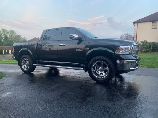

So I deleted the air suspension with the kit from Airdelete.com. love the new setup! So my question is how can I disable The truck from telling me it's in off road 1 and turn the buttons off? I turned off all I could find and no longer get the warning fix air suspension message just tells me it's in off road 1 setting. I have alpaobd.

I used the “borrow the alpha”option through airdelete and by following his instructions had no issues with suspension warnings since
I do recall he was easy to work with so I would give him a call.
I did figure it out with alphaobd. Just took a couple of key cycles and all is good now!!

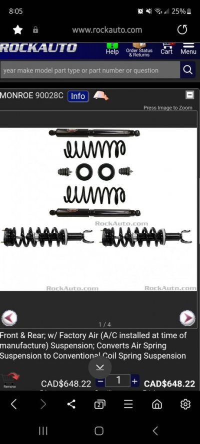

So I just ordered a conversion kit to delete the air suspension. Just have a few questions. The service air suspension and electronic braking system light comes on when the suspence is disabled as well as the cruise control. When the system is deleted is the cruise control going to work? I had it at the dealership and i had an abs sensor and steering wheel alignment sensor code. I'm going to get an alignment after the kit is installed. I'm also doing a 2" lift in the front while everything is apart. Also wondering if I can order a module to remove the dashlight that comes on once the suspension is disabled. I ordered the monroe 90028C1, 2 and 3 to do front and back. Money is tight and just want a smooth and reliable truck. Thanks
