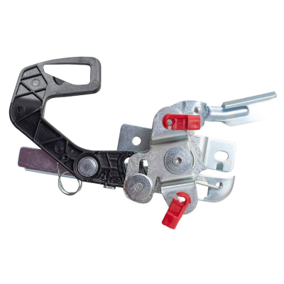

What he is lifting out at 3:30 is just this
with the Tailgate handle, a Lock Cylinder & what is in the image, will be a Manually Locking Tailgate.
Watch this video, it explains everything about the parts needed, if you were to buy this & that
chances are, that your Ram has everything to make the Power Locking Tailgate work.
You just need stuff for inside the Tailgate !!
