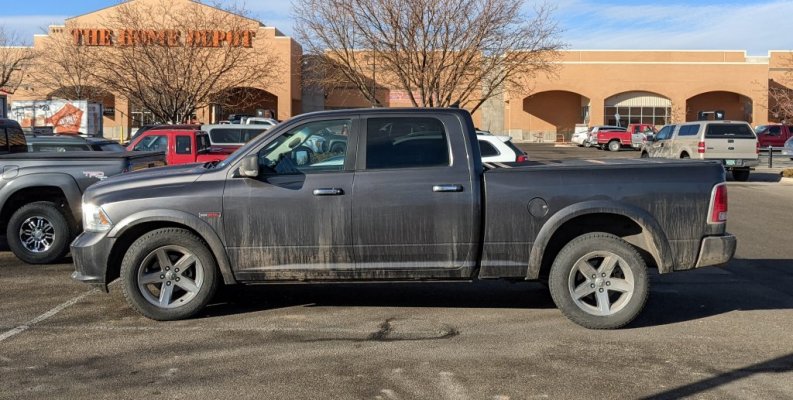

I gotta confess it seemed fine to drive so I've taken it out a couple of times and today I notice it's down in the front. So, is this thing OK to drive before I can get it into the dealer?

So is this thing safe to drive? Even in a limited way?

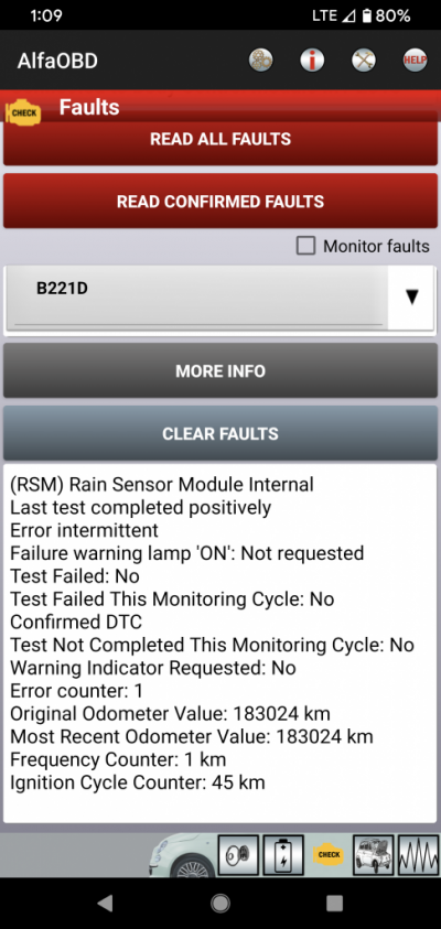

I just ran a code reader over it and the only code I was back was a faulty rain sensor module (?) -- code B221D. Seems unrelated, but I didn't clear it in case the dealer does something with it.

Your reader might only read recent active codes. Probably a bunch of stored codes buried in there.

There's hundreds of posts about various air suspension problems. 90% of which are severe cold weather related. Some people have had luck with small fixes like putting air brake deicer in the compressor inlet behind the passenger tail light. Or wrapping the compressor with a 12v battery blanket. I've found whenever mine freezes up I leave it in my garage overnight with the heat on and it'll be fine for a while. so far (knock on wood) I haven't had any issues, we're reaching our coldest temps right now (-4°F for over night lows the last couple days)
Also, it's "safe" to drive that way, just remember when suspension components aren't working correctly that could cause various traction issues, braking, body roll etc. Also with front low (some experience rear low) your headlights will not shine out as far during any night driving.

The truck honestly didn't feel too bad to drive, perhaps because it was just the fronts, but certainly I would not want to leave it like this.
