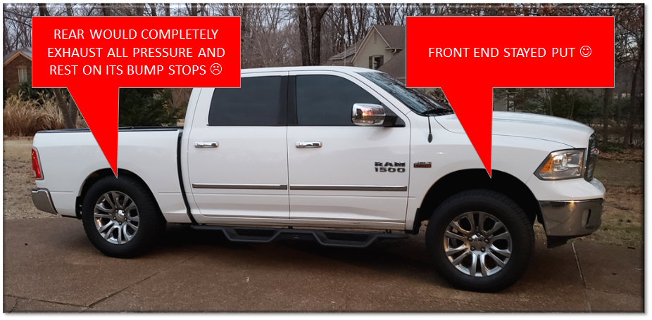

My truck (2014 with factory air suspension) would randomly lower both rear corners evenly to the bump stops
  • Usually happened at night
  • It would correct itself after I started the truck
  • Frequency of occurrence was 1-2 times per week
It would look like this :(
So, over a several week period I documented several approaches to isolate the issue and I have attached them to this thread.
I'm happy to report that the issue was a faulty air suspension manifold (also called a valve block). These manifolds cost $250 new, but I found one on eBay for $60 used and it has worked perfectly for several months.:banana-mario:
