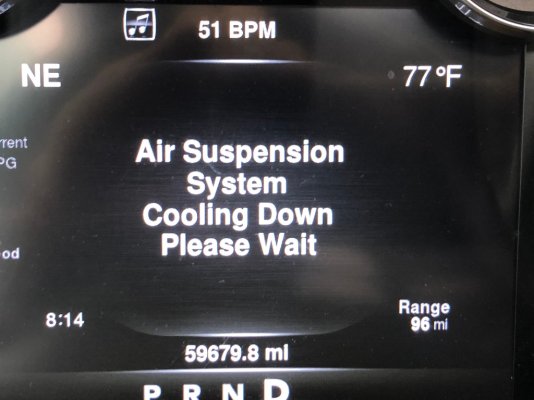

I have a 2016 1500 Limited with Air Ride, the truck has been basically fault free for the entire time I’ve owned it. The air ride did act up before but that was due to a blown fuse for the air ride/trailer brake due to a faulty trailer brake module. Yesterday I went to take it out to go run some errands and the dash displayed the following message:
It makes no sense why it would need to cool down as it was sitting overnight so there is no reason for it to “overheat”. The truck is stuck in normal ride height which is fine by me as that is where I normally keep it unless there is a lot of snow. I have disabled my aero mode so it doesn’t lower itself while on the highway and stay that way for normal street driving. I tried to raise the truck to Off-Road 1 while I was on the phone with one of the dealers it, it went up in which case I thought it was just a glitch and it went away. This morning is did the same thing.
I reached out to 3-5 dealers in my area in Long Island and the and the earliest appointments about a month out. Is the truck driveable in its current state? I asked the dealers and they said bring it in during the appointment and we can let you know. How does that help me when the next appointment is about a month away?
Any help would be greatly appreciated!

The dealer has had my truck for a bit over a week now.
Initially they thought it was the codes which they have cleared. They thought that fixed the problem, I had to show them how to replicate the issue. The issue came back.
Then they thought it was debris in the lines, that was ruled out.
Then they thought it was the valves to/or in the bags, they were replaced and it hasn’t solved the problem yet.
As of now they “think” it is the air compressor.
In the meantime they gave me a 2018 Jeep Grand Cherokee Summit edition, a solid suv it is making me consider selling my wife’s car to get her into it.

They changed the compressor last week which was supposed to have solved the problem. I took my truck drive it for 20 miles and the problem came back, I quickly went back to the dealer. They gave me 2019 ram as a loaner.
think they solved the problem, the air ride suspension temperature sensor was bad it was reading 145° when not in use when the ambient temperature was 60°-70°. When it was in use it would skyrocket to 220°+ which in turn put the air ride in “limp mode”.
I drove it 60 or so miles, raised and lowered the suspension quite a few times.
So far so good.
So far so good.
Interesting. The temp sensor is part of the air pump assembly. Should have been replaced with the pump.
The other day, the dealer quoted me $4,800 ($3500 just for the pump.) to replace the pump and valve block. No thanks.
Ordered a refurb from RMT for $400 and hope that's the only problem.
