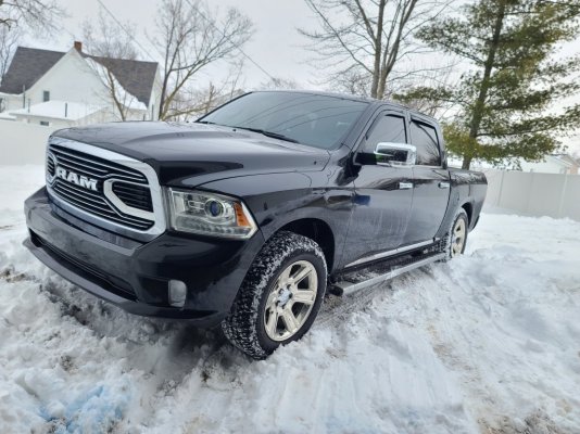

It seems to be more common in my research that the driver rear air bag leaks down. Mine does occasionally if parked off camber over night. No codes or error messages. It will inflate eventually but takes longer than I'd like sometimes. But it's usually VERY obvious that the suspension is down from normal ride height. Old pic from when it first happened you can see the rear wheel gap is less than the front and the truck is leaning. It's been like that for almost 3 years now and I haven't worried about it because it's not an everyday problem. I'd suggest checking your bags, lines and distribution block for leaks.
