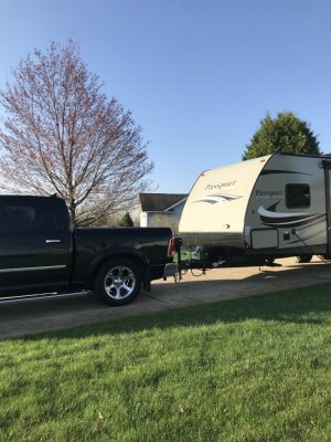

So you still have some squat ? I thought the airbags would help it look level.
I am getting ready to do your excact setup next weekend.
This pic was the first time hooked up I was bringing it home from winter storage and went to a seasonal spot not far from the house WDH wasn’t quite setup correctly 1” high in front and I felt it, it will get its adjustment
Airbags installed this weekend leaving next week
