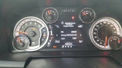

Somehow while just looking through the AlfaOBD app, I managed to f-up my engine hours. I sure don't recall changing anything, but possibly I did! Anyhow, can someone give me an idea how to correct my engine hours?? Please see attached image

Couple of questions.
Where you connected to the cluster?
Is alphaobd up to date?
What obd2 reader do you have?
I had just changed mine a couple of day's ago to update the new cluster and had zero issues

This is a bug that existed in an older version of Alfa. Update to the newest version and connect to your cluster and there will be an option there to change engine and idle hours.
