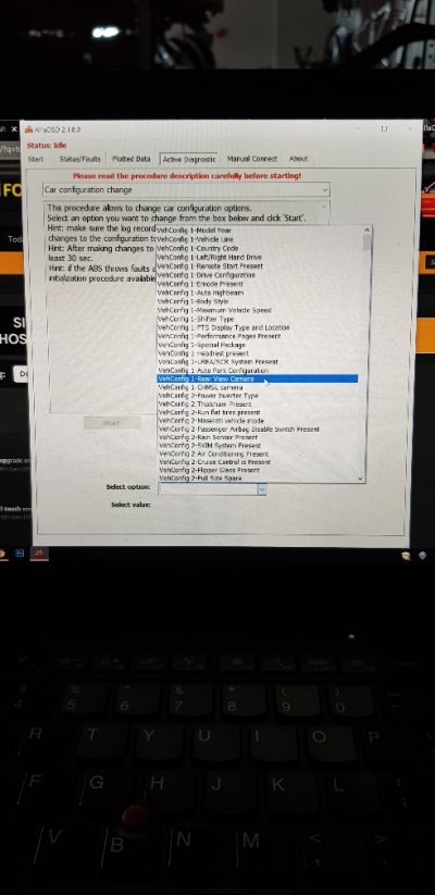

Hoping for some clarity on enabling my newly installed rear view camera (aftermarket) from Infotainment (with plug n play harness). I have enabled two settings under "car configuration change"
-rear view camera = enabled
-chmsl camera = enabled
I am still not getting any video on my ra2 display (blue screen). Do I need to enable anything else, if so, what?
Note: I am getting this code after enabling the two configurations above = U0264
I know the code above is related to the camera, question is, is it configuration or wiering issue?
I searched on here and looked over the giant Alfaobd quide thread but did not come across info that I can try.
Any help is greatly appreciated.

Do you have ECU 3 rear view camera enabled?
Yes, I found that setting after I started this thread. So that has been set to "yes" as well. I am still getting a blue screen and no image and the same U0264 code.
I have checked the fuse box as well as the fuse integrated with the harness from Infotainment and everything looks good.
