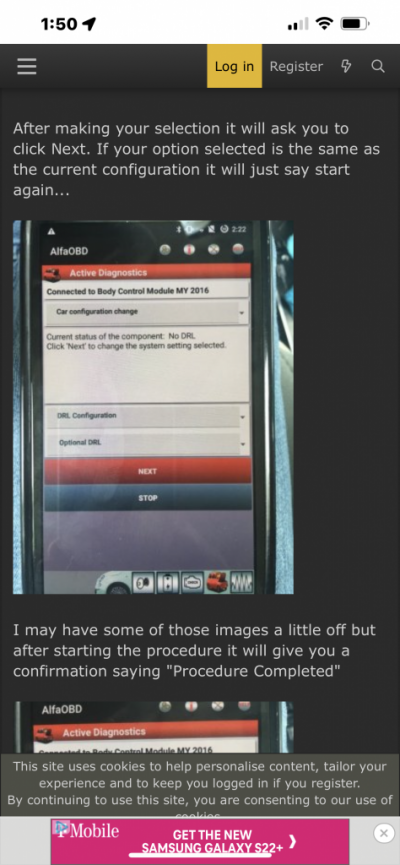

0854B16F-E41C-4262-9624-E0BF84D3462A.pngmine never says “Procedure Completed” and nothing changes when I perform these operations. What am I missing? PLEASE HELP, Thanks in advance!

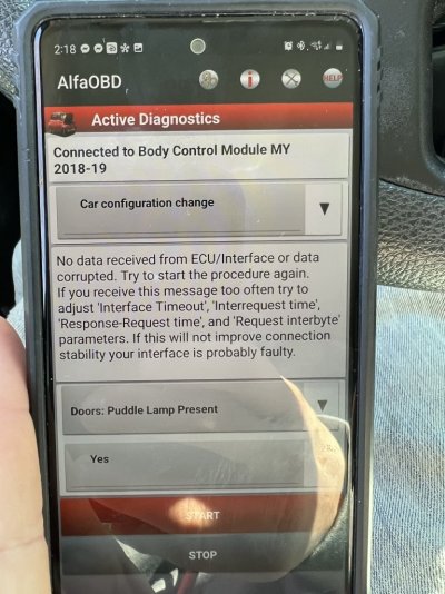

I use an old tablet for alpha stuff and found that turning everything off except blue tooth helped with connection and getting everything to do what it should in the app.

Do you for sure need a “Bypass Cable” to turn anything on or make adjustments on 2018 RAMS? or is there some other way around this with what I’ve got?
Yes you need the bypass cable.

Thank you very much! Got a feeling this is the answer to what I’ve been missing on my quest to get my aftermarket stuff operational.
