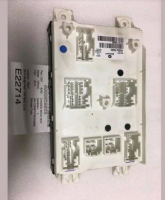

After reading a bunch I'm curious the srt options are stored In the bcm right? So if one were to get a bcm from a loaded srt jeep and plug it in, in theory you could Have the srt options and programming without too much hassle right? Then you could in theory use alfaobd to set up the regular items you had on your truck right?
I'm not sure if It would work or not.
Just an idea rattling around my head.
Edit: I just did a quick search. The modules are physically the same, continental 7 plug blah blah they're identical with different part numbers on them.
Brandon-w
Jan 2, 2019
3,649
6,112
Yukon
2015 Ram 1500
The bcm is the exact same. This leads me to. Think. The only difference is programming #s viper challanger charger and ram share the same style Bcm. If found a Cherokee srt bcm 4x4 and all other options should work in Theory. 20190117_121935.jpg 20190117_121908.jpg
Just a heads up, swapping the BCM with anything but Ram will more than likely result in the truck with a whole list of issues. First things to be addressed would be vehicle line, vehicle brand, chassis type, ABS/ESC, ERS, trailer tow and a whole long list of different settings that are either different or not compatible. Good news is, it would stand to reason that if it was just too much to deal with you could swap back in your Ram BCM and it should solve the majority of the issues.
I haven't swapped BCMs but I have changed vehicle line and brand settings along with using another app and all hell broke loose!
Edit: First things first, make sure you have a copy of your BCM config!!

Exactly. Once you have ur bcm Config you could probly program that srt one to be compatable with the truck. I'm Hoping. When I find work agai and have cash coming in I think I might try it. Chose the Cherokee srt because it has the 4x4 options basically the same as the rams.

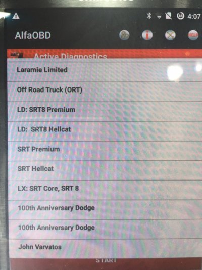

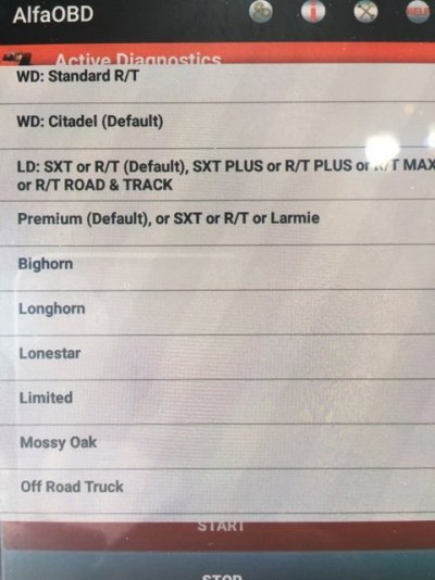

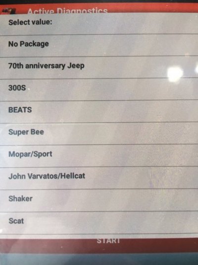

There’s two special packages in the BCM but they’re both the same.
16eb1a01ef46ff9e32ad389533d42005.jpg0cdb1eafcb54b5c40a91de46970d2804.jpg8b88f569e074efbcc9c433833cef9cef.jpg22bac8772e04611e4f460efc334cda4b.jpgff76895ac754126e5d831fe07819966a.jpg
Edit: They don't all work for whatever reason and I had to select the same out of both packages for some to work. Only change I seen was on the evic boot image.
OK so stupid question but if I change these all my other settings stay the same it only changes my evic image right?
