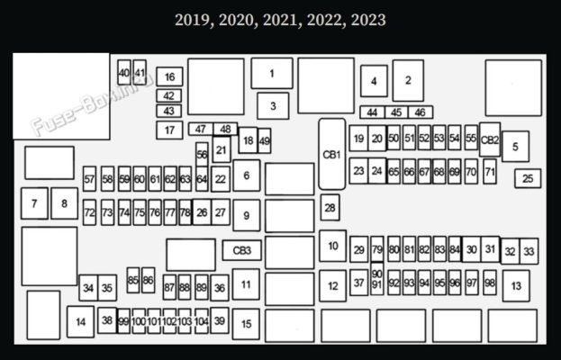

Interestingly enough. I purged my power outlet. ( went dead). Figured I had a fuse to fix. Nope. It reset. But as I did take a look at the fuse box under the hood. I saw a wider fuse is needed next to 93/92. They stuffed a regular size fuse ( 20 amp) in it. I never saw one. Like that. Would auto zone have them??
Not a 3 prong fuse.
In one position, it has power all the time and In the other position, only power when the key is switched on.

Pretty sure it is just like the usual fuse. Two prongs. But farther apart.

I'll rephrase, in case I wasn't clear earlier.
The socket takes a standard fuse. You choose whether you want constant power or switched power to your charging port, by which side of the 3 pin socket you put the fuse in.
The pin on one side is a switched power supply, and the pin on the other side is a constant power supply.
The pin in the middle goes to your charging ports.
I set mine to constant a few years ago.
Yes and no.
As Ken mentioned, it's a standard-sized fuse plugged in on one side or the other.
The fuse in discussion (as shown) is in the F90 - rear Pwr outlet / Battery position, or can be relocated to F91 - rear Pwr outlet / ACC.
