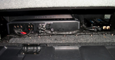

I am in the middle of upgrading parts of my Alpine set up. I swapped out the Alpine sub for the shallow mount pioneer sub but that pioneer is so under powered by the alpine system that I had to buy an independent amp for it that I hopefully get install tom.
I also wanted to be able to control the sub instead of overall bass. I think the speakers sound Alpine speakers sound fine on my Ram but I am a guy who prefers bass over treble. Shoot... when I go see an I-max movie I have to wear ear plugs because the highs from those speakers hurt my ears lol.
Note: Dont buy the 8" pioneer sub unless you plan on giving it an independent amp not worth the money.
Anyways this is my project that I hopefully get installed tom. I already have the pioneer installed but ill list it below.
-Pioneer TS-SW2002d2 8"
-Amp for the sub: Pioneer GM-A3702 500w Max 190RMS
-Sub controller: Scosche LOC90 Speaker to RCA Line Output Converter
