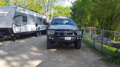

2003 dodge ram 2500 5.7 v8.. I have this truck lifted 2 inches and road armor bumpers. This truck over heats or almost over heats when pulling, i pull a 6700 camper 29 ft. I've had dozens people looks at it and changed it all. I don't even know where to start... I've changed to elec fan. Changed the thermostat maybe a dozen times, new radar and system cleaned, new ecm, new dash custer. New timing cover, New water pumps 3 times, 1 blew up.new radiator caps sereval times. New cooling tubes. Tested block several times by firestone and other professionals. New belts new pulleys new transmission cooler. Ok so I can cruise and everything works not putting extra strain on motor being easy then all of a sudden the truck will say it's almost overheating i dont go over 3 to 4 k so all back off the throttle , as it cools down and then I get by for another 10-15 miles and nothing happens so then I'll keep going and 15 minutes later it'll say it's almost overheating or it is overheatin i pullover I check to see if it's boiling gurgling making any thing to confirm over heating. Nothing get back in truck restart and it's cooled down.. how? It's been 2 mins? I almost think maybe the lines to the radiator are getting pinched shut but is that possible.it's so erratic everytime I tell a mechanic or my mechanics nobody believes me everything checks out everything's fine until you put a load on it and put a load on it it says it's overheating I once was so sick of it I just kept driving I was going up 6% grades in Colorado I drove with it saying overheating for about a half an hour trying to blow the motor I'm just so sick of it I just kept going and going up grates.. over heating and i just keep going taking it easy as can and still says over heating I'm beginning to think that the trucks just lifted and the bully bumpers weight to much so maybe the truck just can't pull it but if that's the case then when it says it's overheating why isn't overheating or boiling.. what to check next? what you guys think? I've tested thermostats after I pull them out and noticed that most of them that I've tried have failed and went bad I've tried every company that makes them for this truck and just keep going bad what's going on?

No other problems on dash i see .. I do my best to fix this truck.. I get alot of compliments for it.. if it breaks I replace it.. I forgot to say it has 20 inch rims and 33 tires maybe it's just to heavy..
