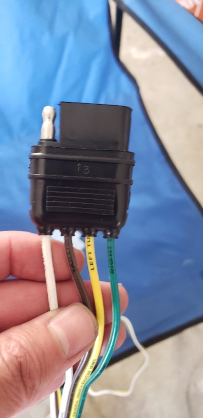

Ok so ive purchased the OPT 7 bar and the Curt 56584 harness. Now what's my next step to get the reverse wired without tapping into the tail light? apologies, i'm easily confused :)

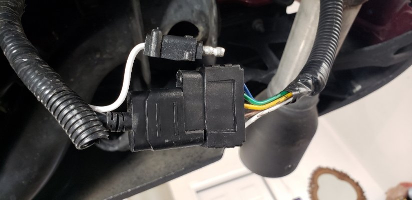

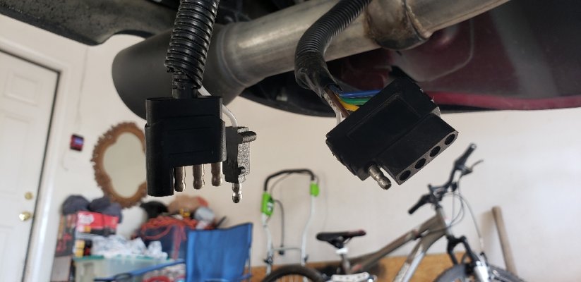

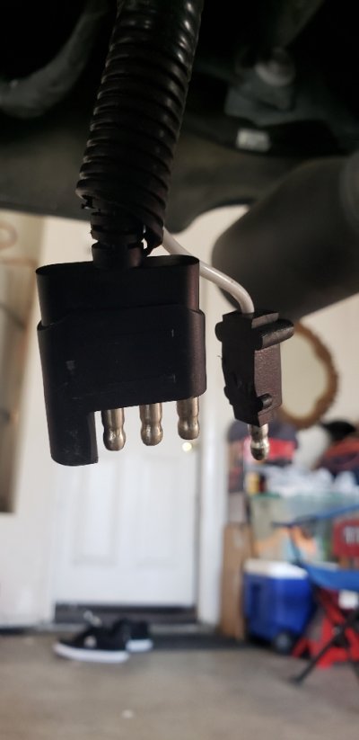

Ok so you are going to do the following
From a 4 pin harnes you are going to cut out just the white wire section to make it look like the 2nd picture
Then you are going to connect that section you cut off to the white wire on your opt7 light bar ... cut the ends to give the same length as the 4 pin piece on the opt7 light bar
It will then connect all together to the 5 pin Curt harness
cb4d4d37048464e496aed8fe69f9092d.jpgc84348a25c91da3c63aa594cf2dd7fb9.jpgc8a9125ae3cab847c805606b138f01b1.jpg
you are the man. THANK YOU.

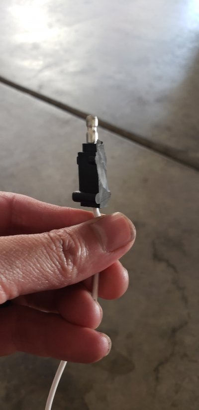

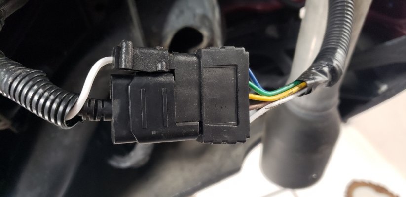

It will then look like the following
On the left side is the opt 7 end with the white end spliced on ... on the right side is the cury harness
2nd picture is how it connects
3rd picture is how it looks connected
