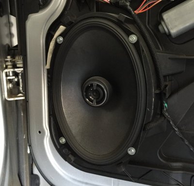

Had my door panels off today doing the running light mod on my tow mirrors. Figured I'd snap some pics of the Alpine to show how it mounts the same as stock.
